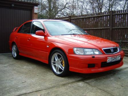

Here is my car, is this the same as the US Honda Accord Type-R??

The US doesn't have an Accord Type R. Over here, the EX model of the Accord has a factory alarm. There is an led indicating when it is armed that is located next to the lock plunger on the drivers door. The only way adding a motor to the drivers door will lock the other doors is if pushing down now on the lock plunger (not the switch) locks the doors.
I would look for the wires I listed above. Over here the 2001 Accord is identical to the 2000 Accord....same in the UK? If you can find those wires, hooking up the locks will be easy.

Yes the 2001 Accord is the same as 2000 over here in the UK. Do your Accords look like the one in the photo above?
