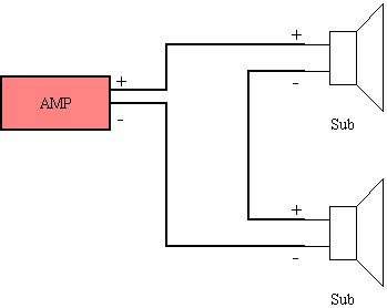

Which model Jensen? XA2250?  The RMS power output on that amp is actually closer to 125 watts into 4 ohms per channel, and that's on a good day.  Jensen amps cannot be bridged into a 2-ohm load, they require a minimum 4-ohm load.  I recomend you connect your subs in series to this amp bridged.  This will place an 8-ohm load on the amp and deliver at best 125 watts RMS to each sub.  Hook like this:
confused about ohms need help -- posted image.

its model xa2125
DYohn
Moderator - Posts: 10,741
Joined: April 22, 2003
Posted: April 08, 2004 at 2:04 PM / IP Logged
Same hookup.  4-ohm stable in mono mode.  Actual output on this amp is about 100 watts per channel into 4-ohms (again, on a good day.)
