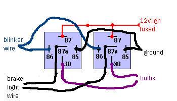

CORRECTION: you have 2 brake bulbs in each tail light? Do as I described, but you'll need 4 relays, one on each bulb. And you can just tie the blinker wire to the 86 terminals on both relays. Heres my best rendition of a wiring diagram. Use a two relay setup like this for each tail light.Blinking Brake Lights -- posted image.

If I have 12+ on both 87 and 87a, it wouldn't blink would it? It would just be switching back and forth from one + to the other. Maybe I am confused. And if I felt 87 open, the blinkers would only operate when the brake light was on.

Damn, your right. My setup would work fine, unless you use the turn signal and brake at the same time. The 87a would be hot from the brake being pressed, so it would be switching back and forth between two 12v connections, therefore staying lit, not blinking. Now we need to figure out a way to kill the power to 87a, only when the brake AND the blinker are used at the same time. HMMM....

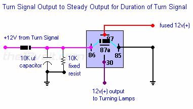

Do some homework, try to see if you can find the turn signal wires in your dash BEFORE they connect to the flasher. If you connect there, you'll have a steady out put when you turn on the blinker, instead of a blinking output. If you can have a steady output for the entire duration that you have the blinker on, that steady output can trigger another relay to kill the power from the brakelight wire going to 87a. If you cant find a steady turn signal output in your dash, maybe you can try this:Blinking Brake Lights -- posted image.
then you can take the wire coming from terminal 30 and use that to trigger another relay wired up like a starter kill relay and use that to kill the brake wire when the blinker is on. You'll end up using 8 relays total by the time yer done, but I think that could make it work like you want to. Look here for more info.

Ok, I think I figured out something a little easier. Thanks for all your help. Here is the new idea, This way, when the brake lights are on, 87 on relay #1 will see nothing and when they are off it will see +12v.

Cool, that would work. I see what you you did, instead of killing the power from the brake, you kill the power to 87 when the brakes are pressed. Why didn't I think of that? :P Except one thing, terminal 30 on the 1st relay you have labeled "to brakes" do you mean the brake light bulb? Cuz thats where its supposed to go.

Thanks alot for your help dude. Yes, 30 on the first relay goes to the brake light, I guess that's kinda misleading. Again, thanks for your help.
