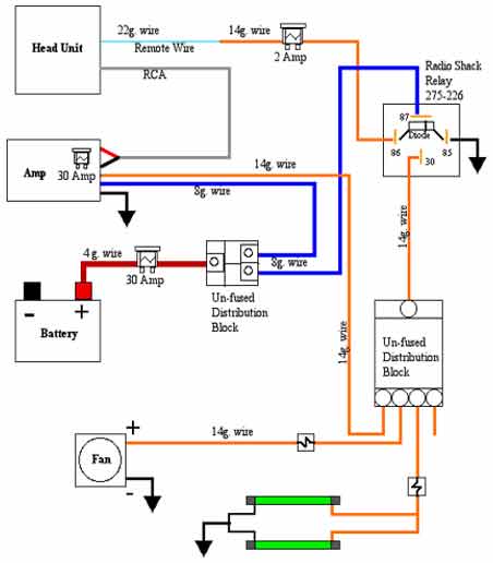

Here is the layout of what I have planned:
Where to buy unfused distribution block? -- posted image.

Posted: April 11, 2004 at 6:21 PM / IP Logged
A terminal strip is perfect for that application.
