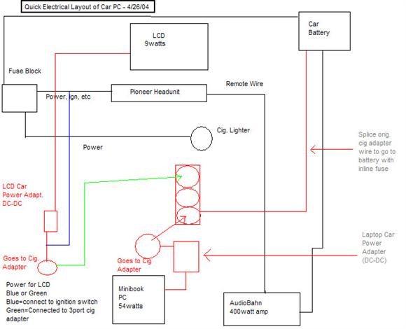

seamonkey420
Joined: April 26, 2004
Posted: April 26, 2004 at 2:21 AM / IP Logged
Here's what i was thinking of...
I'm pretty new to this whole electrical and wiring thing so bear with me... :-)
The red is what i'm adding on..
I guess my main concerns are about wiring the 3port cigarette adapter directly to the battery and if i wil blow stuff or not.. but the inline fuse should prevent that..
another thing is wiring the lcd to the ignition wire, i assume this is the same one on my deck/wiring harness? would i wire the lcd directly to the unit or can i wire it to the car power adapter?
again thanks.. below is what i'm trying to do..
https://www.the12volt.com/installbay/uploads/ElectricalIdeas_Custom.jpg

seamonkey420
Posted: April 26, 2004 at 2:23 AM / IP Logged
didn't work first time, sorry.
LCD monitor powering -- posted image.
