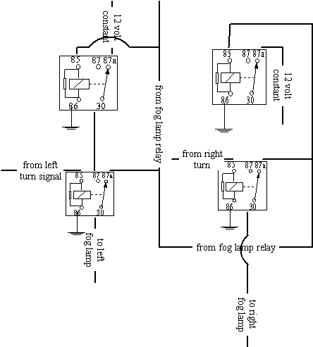

I have a customer who wants to replace his lower blinkers with foglights. The foglights he purchased fit exactly where his lower bumper blinkers are. He wants them to be wired as foglights, but blink when he puts the turn signal on. I need to figure out a way to have the foglights blink (whether they are on OR off)whenever he uses the turn signal. The truck is a 88 Mazda B2200 in case that info is needed. Thanks!

Fog lights in place of blinkers -- posted image.
this is the schematic that you should use to hook this up. The lamps will flash on off on off when the fog lamps are off and the opposite when the lights are on.  the half circle lines mean that those wires do not connect, they cross over eachother. Hope this works well.

Ok, but I'm confused about the relay on the upper right. What is its purpose? nothing is connected to 30 or 87 Is 30 supposed to be connected to 87 on the relay below it? Just like the two relays on the left?
