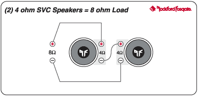

Each channel is 2Ohm stable. i.e. you can "present" a 2ohm load to each channel on the amp. But if you bridge the two channels (Left ch. + and right ch. -) it is only stable at 4Ohms.
Refer to DYon's post... "either hook one sub to each channel (un-bridge it) or conenct the subs in series for a total load of 8-ohms on the bridged amp."
Here:
amp cutting out -- posted image.

With the speakers you have you cannot.  Like I said earlier, your only choice is 4-ohm stereo (or 8-ohm mono.)  It is because of the electronics.
