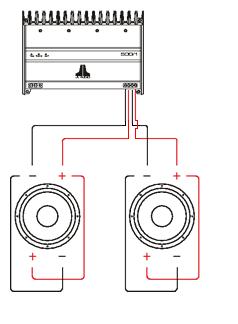

Like the topic says...
2 [4 ohm DVC] wired to at 2 ohms.///
My amp is a Kenwood KAC-7201...
stable at 2 ohms
I have 2x Audiobahn
AW1251T
12” NATURAL SOUND WOOFER
45 oz. Strontium Magnet
Power Handling: 400 watts RMS
Frequency Response: 24Hz - 1kHz
Efficiency: 92.1 dB
PHAT Foam Surround
Non-Pressed, Non-Transfer Paper Cone
KM3’ Coated for Virtually No Cone Distortion
2” 4-Layer ASV Voice Coil
Dual 4 Ohm
2 or 8 Ohm Operation
Mounting Dimensions: Depth; 5 1/4”
Hole; 10 7/8” Diameter; 12 1/2”
MULT-CONNECT Lug Lock Terminals
My local stereo shop told me to wire my subs like this..
2 DVC drivers with Voice Coils in Series / Parallel
Dual-4 Ohm Subwoofer: 4 Ohms
AMp set to MONO with LPF on..
two 4 ohm DVC wired to at 2 ohms -- posted image.THis doesn't seem right??
Now the way i had is running orginally.. was
2 DVC drivers with Voice Coils in Parallel / Parallel
4ohms running on each channel on STEREO with LPF on..
can someone explain and maybe even solve the problem

your pictures didn't post.
you could only get 2 4ohm dvc subs to 2ohm if you ran each one to its own channel in a parallel circuit. if you wanted to bridge the amp you could run the subs to that with a parallel/series or series/parallel setup. that would give the amp 4ohms/2ohms per channel. just about the same as running each sub to a channel.

Your amp is stable only at two ohms stereo, not mono. 2 ohms stereo is the same thing as 4 ohm mono, thus the pic that shows above is the correct way to wire the subs to your amp and have the amplifier reach it's maximum output capabilities safely.

OK so let me understand this..
If i follow the first diagram above.... when there bridged..   in STEREO it should be fine.. i have them on MONO and no sound comes out...  so i turned them off.. and i have not turned them on since..

I have the same wiring as you posted above. If it is run in stereo your amp will be at a 4ohm load. If you have the amp switch to mono your amp will have a 2 ohm load.

so y isn't it working.. i have it run in MONO like the above configuration and no sound is comming out of it..

As forbidden said, the Kenwood KAC-7201 is NOT stable at 2-ohms mono.  It is stable at 2-ohms in stereo only. It requires a minimum 4-ohm load in mono.  So if you have your speakers wired for 8-ohms, and then in parallel to the amp you are fine (4-ohms.)  If you have your speakers wired for 2-ohms, they must be in series to the amp (4-ohms) or connected to the amp in stereo (one sub to each channel.)  If you have your speakers wired for 2-ohms and then they are in parallel to the amp in mono, you have created a 1-ohm load which the amp will definately not handle.  Indeed, if you had a 1-ohm load on that Kenwood, it is possible you have fried the amp.  If you are unsure, get professional help from an install shop.  I assume you have checked all your fuses as well?

when i first turned it on i got no sound... then i turned it off and tried again and then nothing happened.. so i checked the fuses on the amp and they where both blown.....

Then I suspect you have the system wired wrong.  You need to re-wire as described in this thread.  If you do not understand all the information already posted for you on this thread, I respectfully suggest you go to your nearest install shop and get some help.
