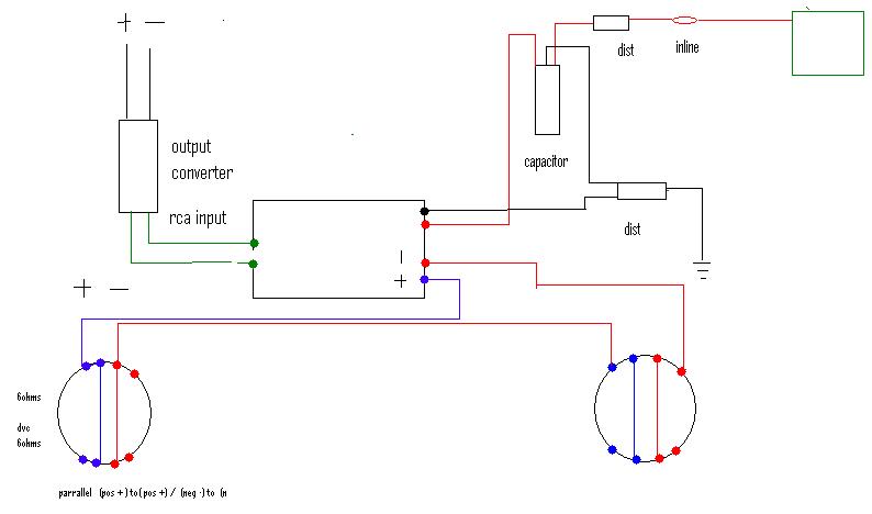

    deboss
    Member - Posts: 9
    Joined: June 07, 2004
    Posted: June 07, 2004 at 12:45 PM / IP Logged
    so i should wire it this way parallel to series right amp wiring question -- posted image.
    DYohn
    Moderator - Posts: 10,741
    Joined: April 22, 2003
    Posted: June 07, 2004 at 3:17 PM / IP Logged
    That looks good to me.
