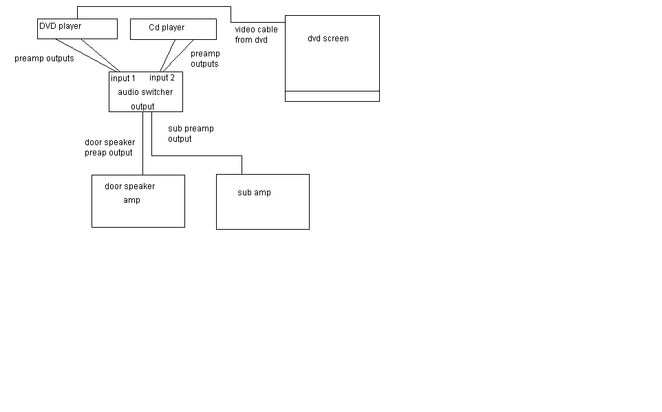

I know there is a dual reciever switcher on crutchfield but I'm not sure where. You might want to give them a call. You can set it up like this:
9EC_audio_video_switcher.gif (make sure to enlarge it to its biggest size in your web browser).

Does your Alpine CD deck have an auxiliary input?  If so, leave your sound system connected to this deck and connect the audio out from your DVD to the Aux In of the CD player.  This way, you can have them both on, but you will only hear the audio from the DVD if the Aux input is activated on the CD deck, otherwise you will hear whatever is playing through the CD deck..  No switcher needed.  Make sense?

yes. Just use the auxillary input on your cd player for the dvd sound, then if video is going to the monitor, you can turn the cd player from auxillary to the radio and your dvd player would still be sending your screen a video signal.
