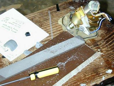

I had the same problem with my 1996 Accord. I decided to opend the driver door and take a look at the lock actuator. I suspected that was the problem. After getting it out I called the dealer. The part cost $130 and installation by the dealer was another $130. The actuator is not a sealed until. I opened it by removing the screws. I found that the rubber stop was cracked and was failing to stop the swing arm in the correct position. It was leaving the circuti open instead of closing it.
I fabricated a stop myself since the whole actuator was expensive and the dealer did not sell just the rubber stop. See uploaded image. The black rubber stop on the white paper is the defective part. The grey stop on the actuator is the one I fabricated. I made it from a rubber foot I took off a bread machine before throwing it away.
I hope this helps.
1994 Honda Accord Coupe Door Lock Relay Location -- posted image.
