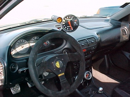

Motorized fold-up airbag cover? -- posted image.
This is not my car, but you can see the airbag cover on the passenger side. I'd like to make that fold up (hinged on the windshield side) to reveal an LCD or gauges, whatever.. I've done some searching and couldn't find what I was looking for. Any ideas on where to look or start on such a project? ie. what kind of motor/solenoid to use, etc?

What your going to want to use is a small actuator (shorter will probably be better , but only a trial fit will tell) and some cabinet type hinges from like home depot . Hinges that open up and away do good , you will need to trim the factory cover since it has a retaining lip around the sides  and the airbag removes easily(disconnect vehicle power though) . It will take some trial fitting and moving to get the actuator to open and close fully being mounted (if you don't give it full range of motion than you may encounter problems down the road , and possilble problems means possible free labor to fix ) but if you are just wanting to put the gauges in there than you may just want to buy the gauge bezel from like NOPI that is a factory replacement with 2 gauge mounts in the corners by the smaller gauges of the factory cluster . I only offer that option because the time and money factor for the custom actuated airbag door may be more than its worth it to do it for , and that can open up  money to do other options like upgrading the factory hu or add a sub . You know your friend will spend the money on his car so show him what more you can do for him with the same money and less time and headache .  But a fiberglass gauge pod under the airbag would be cool , so see what they want to do . Later

Before you make any modification like this please remove yoiur air bag entirely. If you do not, and the air bag goes off in an accident. the parts of your new custom dash will be ejected like shrapnel. your pasanger will be waring your LCD display like braces. I would recomend looking for a diffrent location. Head rests, Visors, Rear view mirror etc, for the LCD display. Low on the dash etc for guages.
