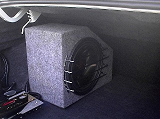

Posted: July 21, 2004 at 10:30 PM / IP Logged
I built a box for a single 12" for my Taurus, and made it a little different than usual.  The speaker is mounted into what looks like the side of the box, and the box angle allows it to fit all the way back against the rear seat.  The woofer fires toward the center of the trunk space.  It works real good in my car, but the angle of the box and the cutout on one side like this means you can use it only in one position in the trunk...no moving it around to find what sounds best.  Your car should be similar in size to my '01 model.  Here is a pic of the box.sub box -- posted image.
stevdart
Platinum - Posts: 5,816
Joined: January 24, 2004
Posted: July 21, 2004 at 10:35 PM / IP Logged
This is in the trunk.

Posted: July 21, 2004 at 10:41 PM / IP Logged
For two subs I think I'd put the back of the box against the rear seat and face both subs toward the rear.  You can do an angle on the back side, if necessary to get it back further.
