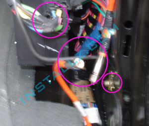

You might want to pull the passenger side kick panel and check for power and the antenna lead there. If it IS there, you'll need the 40-FD30 metra antenna adapters. Either way it's still more convenient than pulling the radio and running wires up there. Here's a pic of the kick panel from a navigator.
DVD Install 2004 Expedition with moonroof -- posted image.
You can see the antenna disconnect (if using an FM mod), the power wires, and a factory ground circled. So basically run your wiring to the pass kick and be done with it. Also be sure to put fuses on your wires! In that harness in the kick the thick yellow would be your constant power, blue/green would be your ignition power, gray / YELLOW would be accessory. Should cover any wires you would need. Again take a minute quick to pull the kick panel and verify if everything is there.
As far as running wires around the airbags just be careful and use common sense. Keep your wiring more on the inside of the airbags themselves, try and push it a few inches over on top of the headliner. Also once you pull all the door seals you can tell just where an actual bag would deploy and where a "safe" spot to run the wires is. Good luck,
