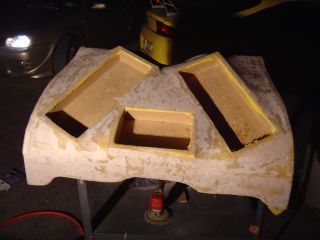

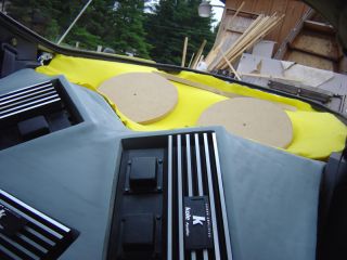

HOw smooth is smooth enough???there is the question of the day...
This is smooth as a fat chicks ass below
how smooth is smooth enough? -- posted image.
THIS PICTURE is as smooth as Jenna Jamesons big round voluptous bre.......enough said. Below
To me...smooth enough is when you can take two fingers and start on one end..WITH YOUR EYES CLOSED..you dont wnat anyother senses screweing up your perception..go back and forth..whenever you feel a pit..or a spot that is wavy..circle it with a marker....at this point you should have a piece of fiberglass that is as pimply as a fat chicks ass as well. Now you want to take bondo and lightly glaze over those areas..then sand..and TEST AGAIN. when you have smooth as a baby's ass..then you spot putty (unless you use a high build primer) and start wet sanding.
any questions AOL IM PimpGtiVR6 337
