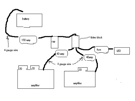

What is the amperage draw of the LED light?  And does it have its own in-line fuse too?  The general rule is:  every appliance should have its own fuse, every wire that supplies current should have its own fuse, and the wiring must be capable of supplying the power without overheating.  Your system should have a 4 gauge wire from the battery, fused with up to 150 amps to protect that wire (or the combination of every fuse rating in the system it is supplying).  It should run to the capacitor, then on to a distro block.  The block should split to 8 gauge wires to each amp.  Those wires should be fused at up to 100 amps each to protect those wires, or at the highest rating of each amp (in your case one is 60 and the other is 30).  A separate wire from the distro should supply the LED, and a fuse on that wire, too.  That will probably take a 20 amp fuse, but look at the LED and see what amperage it draws.
A fuse blowing is most often an indication of a wiring short.   Get all the wiring and fusing done as shown here, and when a fuse blows next time you will know what caused it.  The closest fuse to the problem will blow.
fuses blowing -- posted image.

I can't believe you...I drew you a wiring diagram ( This post from earlier today), and told you that almost all blown fuses are caused by a short in the wiring, and customsuburb came on and told you that the amperage you're pulling with that light is less than 1 amp....and all you got out of that was to put in bigger fuses???  Take the advice you are given on here before you come back screaming for more help.  Sheeeesh.

I checked all my wiring and everything is hooked up correctly. I have the power lead coming off the distribution block. I have the light grounded on a chassis bolt.
So I already checked the wiring when I went to get a bigger fuse, because that seems to be the only thing left. I have it hooked up like your nice little diagram you gave me bud!  Any other bright ideas?
