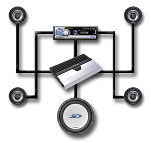

I was on Alpine.com and saw this image and i was wondering if Alpine is wrong in telling people that this is a good setup. (see picture)
Cant get amp to power subs and 6x9s -- posted image.
Alpine Guy
Platinum - Posts: 2,478
Joined: October 18, 2003
Posted: August 07, 2004 at 2:52 PM / IP Logged
That would be a 4 channel amp there, , 2 channels are running the Fronts with there own crossover network, , then the rear chanels are bridged to the sub and they have there own crossover net work too.
You should run your 6x9's off your deck, , and bridge your subs onto that 2 channel amp you got, , or do your equipment sum justice, , and bring it to a shop to let them set it up for you.  After its set  up, , keep your pinkies off the gain and boost controls.
In this case, it is more than a two channel amplifier, possibly a four, or now they make what is referred to as a five channel amplifier. They are designed to run four sets of speakers, and a sub being the fifth channel. IMO, it is a better choice to buy dedicated amplifiers for what you want to amplify.

jakediggity wrote:
"Yeah, never use 1 amp to power subs and full range speakers.  Even if you have HP/LP coils and capacitors in the circuit, they are so inefficient you lose A LOT of power.  Quit being cheap and buy a second amp or power the rear speakers off the radio"

Guys that could also be a 2 channel amp and still use caps and coils to make it operate. As it is a generic picture we need to consider this possibility as well. Even though it does not relate to the question first posed. That said though, it is a safe assumption to also think that it is a 4 channel amp bridged into 3 channels.
