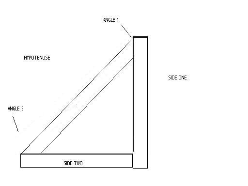

stevdart
Platinum - Posts: 5,816
Joined: January 24, 2004
Posted: August 12, 2004 at 9:01 AM / IP Logged
In this diagram, if side 1 were 15" and side 2 were 14", the hypotenuse side would be 20.5" [the square root of (side one squared plus side two squared)]
If you enter the numbers into the calculator in the link I provided above, using 15 for side one and 14 for side two, the angles of the cut are shown for you.  The angles are calculated at 47 degrees for angle 1, and 43 degrees for angle 2.
how do i cut these angles? -- posted image.
