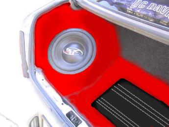

sorry, guess my post may have been a bit confusing. I meant only sealing the trunk from top to bottom on the sides, and leaving the middle part of the trunk open. Here's an example that I just came up with using my trunk. That's about where my sub is now, but I lowered it a little bit and everything else is just painted.

I played with that idea for awhile but I would like to vent the box to get as much SPL as possible...now I am venting at a low freq so I can obtain a good level of SQ as well... I am just still trying to figure a good vent mach to stay withen if I am firing subs into the cab
