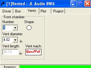

No, that will double the area of your port and change the tuning. Click on the vents tab, choose the number of ports you want, the shape of the port you want, the diameter of the port you want and it will tell you the length you need. But you have to input your enclosure information so it knows what to tune the box to and what not. Here's a picture:
Ported Enclosure -- posted image.
