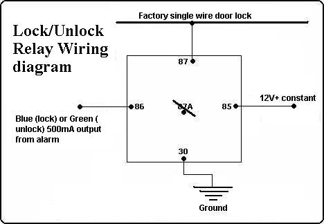

thought i'd add this incase anybody can come up with a relay wiring description for me..
not locking/unlocking on arm/disarm -- posted image.

Both relays: 85 constant +12V, 30 ground, 87 output. Lock relay will have 86 lock output from alarm. Unlock relay will have 86 unlock output from alarm. Place correct resistors on the output of the lock and unlock relay.

so we talkin like this?
and i'd need a relay per wire comin from the alarm? one for the unlock output and one for the lock output? and where would i put my 1.5k Ohm resistor for the unlock wire? before or after the relay?

the info i have for a '99 Stratus says: "Use positive (+) trigger thru a 620 ohm resistor to lock, and a positive (+) trigger thru a 2.7K ohm resistor to unlock. Must use relays. "
Yup your right, I didn't research it. Your diagram would look like this but with the correct resistors in place between 30 and the car's wire.
