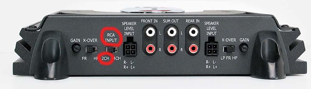

If your amp has a switch labled 2ch. on one side and 4 ch. on the other then run your single rca cable to the front inputs (if you dont get any sound connect them to the rear instead). Then switch the switch to the 2 ch. Here is a picture: amplifier_side.jpg

If the amp doesn't have the switch shown above, you would buy two Y-splitters (1F-2M).  Connect the RCA's from the head to the splitters, then run one into both front and rear left, and the other into both rights.
