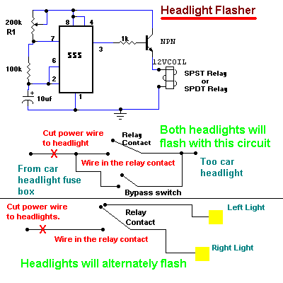

Hi Folks
Does anyone know how to wire up 1 "maybe 2 relays" to flash both headlights but at different times ie: When the left side is on the right side is off
I am going to add this on to a Clifford system so they flash when the alarm is activated
Cheers Dan

Here is one way.
Relays / wiring for headlight flash -- posted image.

Here is one I just made up for you with 3 Relays.

Hi John
Thanks for the reply.
I think i will use the Wigwag headlight one
Cheers Dan

Posted: September 23, 2004 at 5:28 PM / IP Logged
This circuit called Wig Wag has not been tested.
It was an Idea I came up with.
 Let me know how it works please.
