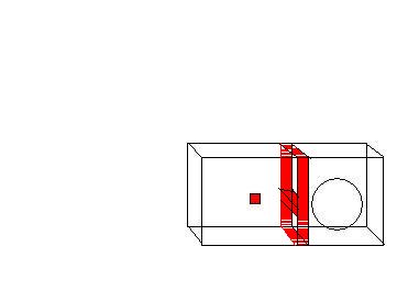

Jvee, sorry for the attempt at early morning humor there.  Your car is no doubt a nice ride.  But to the point:  the box you build, being flat in nature, should have more rigid walls than 5/8".  The larger the area in square inches of any wall, the thicker it should be.  I would use the standard 3/4, although your experience with fiberglass resin coating may prove me wrong on this.
If I had an enclosure that looked something like this, I would add a brace from front to back in the center of the largest expanse of field, like what is shown with the red dot.  And more bracing on the other side of the speaker hole, also in red here.  That will help prevent flexing of the front and back panels.  The sub in this case would be inverted, as there is not enough depth to fit the entire speaker into the box.
