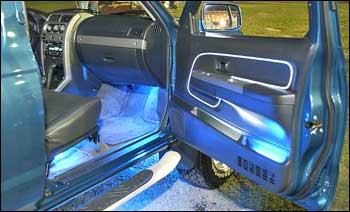

  • LED or NEON?  i have read a little about each and they seem to be practically the same thing.  would a little neon tube be cheaper than a couple LEDs? How many LEDs would it take to make the floorboard solid blue (and now also thinking about putting a few in the little map holders in the doors LED wiring, door activated? -- posted image.)  Like this:
My IDEAL setup for this would be the lights come on when the door is open and turn off when the door is shut as well as have a little switch to turn them on while the car is running if i want.
  • If i wire a few LED's (or neons) together in parallel (say 4 LEDs), i would need a resistor and relay right?  If i fire them up and decide it is not enough light for me could i just tack on another LED or 2 in the chain or would i have to rewire them all? Can i/should i wire both the driver and passenger side lights all together to save from headaches?

Led's are great for spot lighting or when used in close proximity a really bright area. Neon is quite cheap and lights up a much larger area with a much closer spread of light much more uniform in brightness.

Nice, I think it looks like neons are the way to go.  Can neon tubes (10-12") be wired together without straining the battery?

Neons can be wired together and are also a simple two wire hookup. They draw very little current and can be powered off of a 12 volt cordless drill battery for a looooong time. I would not expect a issue with a vehicle battery at all.
