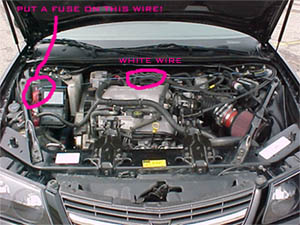

Posted: October 03, 2004 at 12:59 AM / IP Logged
If you look in my picture you'll see the circle near the back of the engine. All the spark plug wires should be going to this module, and there should be a wire harness coming off of this module. You want the white wire at this module. Feel free to unplug the wire harness (with the car off of course) if it makes it easier to tap into the wire.
Also it looks like that blue wire I circled isn't fused.. If so, put a fuse on that before it causes any trouble.
2003 Chevy Impala tach wire - Page 2 - Last Post -- posted image.
ivanca
Member - Posts: 34
Member spacespace
Joined: May 18, 2004
Location: Canada
Posted: October 03, 2004 at 1:04 AM / IP Logged
Thanks so much. I stay on line for your guy's answers.
My friend told me that tach wire should not work well because tach signal is not strong on GM car. Is it right?
And where is the injectors? Coudl you circle it out?

Posted: October 03, 2004 at 2:10 PM / IP Logged
Thanks your guys!!
I finish it and it work well now. In Impala 2003, It is the TAN/BLACK not the WHITE wire.I tried White wire but didn't work.  Only the TAN/BALCK wire works well. See the picture below:
