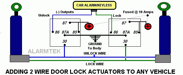

not so easy as it sounds.. deal is.. i am installing power door lock actuators.
The actuators are ones i found local, 2 wire.  So this makes it necessary to Reverse the polarity (open vs close).
I'm having a hard time tumbling this in my brain.. hard nite drinkin last nite...
Any ideas boyz?
insanity

Or you could check this page out:
http://www.relayhelp.com/
door locks.. Relay for switchin polarity -- posted image.
