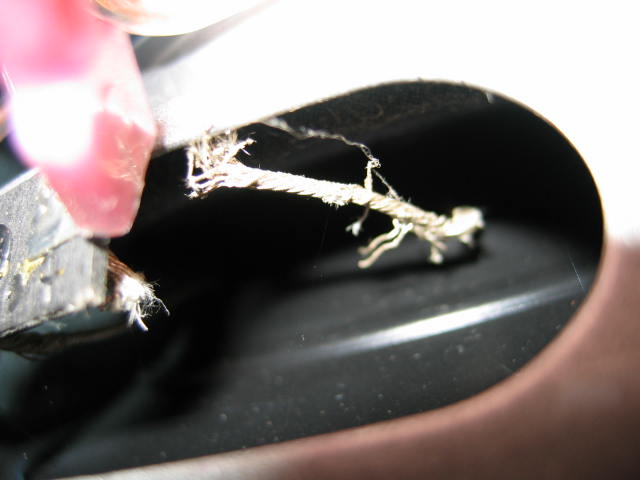

I've got a JL 8w3v2-D6 that is in good condition except that a lead wire on one of the voice coils is broken/frayed. The other voice coil plays fine, so i want to repair it. Can it be repaired and if so, how should I repair it? I appreciate any help you can give..................
I am going to try to post a pic of it on this but we'll see if it works
Also, I haven't decided on what amp to use to power this sub. It's rated at 125w RMS continuous. Any suggestions? It will be a single sub set-upLead wire damaged, repair? JL 8w3v2 -- posted image.

Ive been able to solder those wires on different subs before but they didnt have the excursion that JL has. Im sure that can be fixed but hold out for others here to reply who can help more with that. As far as your amp , there are soooo many choices but it mostly depends on your budget and what you want to spend. I can at least tell you that you want to look for a single channel , mono block amp , steady to 1 ohm. Again it would help to know your price range.

I have repaired a few and its been alright,   i would try to salavage as much of that lead wire as possible by soildering it together and then soilering another wire onto it...make sure you leave enough room for excursion but not too much so it dosent flap around...as for an amp your only going to be able to get a 12 or 3 ohm load, kinda ugly but a single mono block amp stable to one ohm will do...look for something more around 200 rms, shouldnt be hard to find...you can over power these like mad!

Length will be a problem when you try to solder it back on.  Use a additional 1/4 or 3/8 inch of wire and solder it back in to give yourself some room for excursion.  If room is tight wedge something between the basket and the frame to move the cone away from where you are working.  Be careful when you do that and do it in more then one place.  It can be done, I've done it : )

JL has a flat speaker repair program for $53.00 on the 8w3v2
