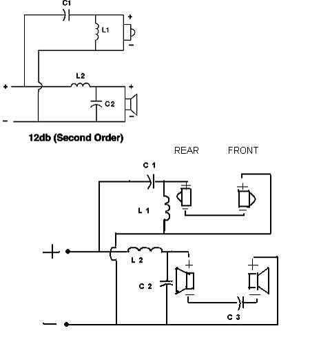

This isn't a car audio question but I trust and respect the pro's on this forum so here's my project.  I'm building rear surround speakers for home audio and have decided on using the dipole type for my older Pro Logic receiver.  This pair of speakers will each have a small woofer and tweeter on front and back in a mirror image arrangement.  I need some guidance in building a crossover for each of them.  I already bought the woofers and am looking at getting the tweeters.  The ports are already purchased.
Parts list:  woofers (4)  .........  Tweeters (4) _(besides low cost, selected for their small size)..........  ports are 1" x 4", to be cut, and the crossover components will also come from PartsExpress.  From what I've read about the ProLogic receivers, the sound to the rears is a limited frequency response of about 100 Hz to 8000 Hz, and my Yamaha amp gives each speakerbox 20 watts @ 8 ohms.  The THD is relatively high to the rears compared to the main and center speakers, so high quality components wouldn't be needed here.....and so I think this is a good way to try making crossovers for the first time.
DYohn told me recently that I should reverse polarity of the opposing sides, and highpass the front speaker at about 250 Hz , so I have purchased caps for a first order highpass.  I will need to purchase the rest of the components for the crossovers.  The diagram below shows an example of a second order crossover.   I used that as a guide for my working-model diagram below it which includes the second set of opposing speakers.
crossover design for dipole rears -- posted image.
C3 represents the 250 Hz highpass filter.  I bought  these caps so that I could parallel two to each front woofer for a total of 160 uF to highpass at 250 Hz at 4 ohms.  The crossover should be at 3500 Hz.  I need to kow this stuff:
1  Would  the crossover work as shown in my diagram?
2  Can I put the 250 Hz highpass where it shows in the diagram?
3  Can I use one crossover for each speaker box (as shown)?
4  How do I determine the final impedance of the speaker box with these speakers?  And how does the crossover affect the final impedance?
When I started this, I thought I would get by using only the woofers, but their range is only to 5000 Hz.  That's why I bought them as 4 ohm woofers to be series-wired to an 8 ohm load.  Now I don't know how adding 6-ohm tweeters and a crossover will affect the total impedance.
5  Do I figure crossover values on the total of the series-wired speakers, such as at 12 ohms for the tweeters, and at 8 ohms for the woofers?  I already figured C3 at 4 ohms because it affects only the front woofer.

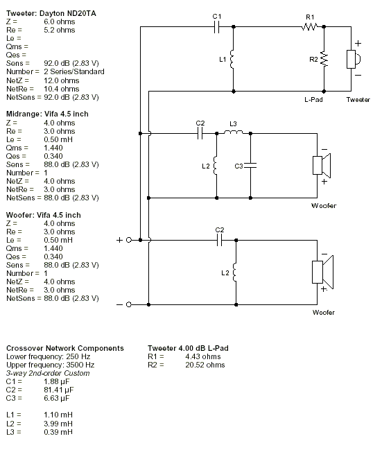

Here is how I would do it...
The answers to your questions -
1. No
2. No
3. Yes
4. Won't be easy. Something like 4 ohms below 250Hz, 2 ohms 250Hz to 3500Hz, and 10 ohms 3500Hz and up. If you were to add a 1 or 2 ohm (10 to 20 watt) resistor in series with the whole enclosure (in the speaker wire between the receiver and speaker) you can bring those resistances up to a more realistic load for your receiver.
5. See diagram and answer 4.
These values are pretty exact, and provide/allow some fashion of impedance control. The values are a little wierd, but you will likely not affect performance much if you stick ACAP to the listed values. Do not leave the tweeter pads out, unless you like it REALLY bright. The tweeeters will be about 4dB hotter than the woofers.

haemphyst, what crossover design program do you use?

The old-school JBL SpeakerShop. It has crossover and enclosure modules, supporting 1st thru 4th order, in 2 way and three way versions. You can add drivers to the database. PR, Band-pass(4th, 6th, and 7th order), sealed, and vented enclosures are supported. Pretty good, all-in-all. A little tweaky in 2K and XP, but only when changing window size...

Haemphyst, thank you for the input.  In the diagram you show, first with the tweeter:  it looks like I should just series-wire the rear tweeter to the tweeter shown?
The bottom woofer looks like a highpass crossover because it has the same allignment as the tweeter.  Is it right?  It should lowpass at 3500 Hz.
The middle woofer represents the front woofer, which is to be highpassed at 250 Hz and lowpassed at 3500 Hz?
Do I reverse the polarity shown on the center woofer so that it is out-of-phase with the opposing woofer?

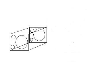

This is a rough outline of the dipole arrangement:

Yes, the second tweeter is series wired with the first.
Yes, the bottom woofer is HP at 250Hz. Actually, what you need is the middle woofer to be the front one, as it is bandpassed at 250 to 3500, so that is good. I was wrong with the bottom one, it should be lowpassed at 3500, and the amp will "high-pass" it at 100Hz. Use L3 and C3 values in the same places, but on the bottom woofer. I copy/pasted the wrong components - sorry, and good catch!
You can do the phase thing, if you like, but for my money, it will make placement far more critical, as far as spacing to boundary walls (rear wall, specifically), and I personally would try it both ways, to see which worked best in my application. I am not saying DYohn is wrong, I'm just saying try it both ways to see which works better for you. Also remember, if you change the phase on the rear woofer, also do it with the rear tweeter, so as to avoid possibly unacceptable phasing and lobing issues.

Okay, thanks.  I'll change the values on the bottom one (rear woofer) to L3 and C3, and reverse the configuration so that the coil is in parallel and the cap is in series.
On the middle bandpass figure (front woofer), is the order of components shown correct, then?  The cap C2 is before the coil L3.

Yes... that information is correct.

A couple of points: If the speakers are in phase, it is a "bipole" system.  Bipoles are very good in AC3 or 7.1 side fill systems with lots of side ambience.  Wiring them out of phase is what makes it a "dipole."  Using true dipoles is really only satisfactory with Dolby Pro Logic (or older) surround systems.  My suggestion for keeping one of the woofers highpassed at about 250Hz in relation to the other creates a modified dipole, where one woofer operates as a monopole below the high pass frequency.  Its bass information will not be diffused and will remain in phase.  This is more satisfactory with modern surround schemes that include more direct program information in the rear channels.  But I agree, try it both ways and see what works best.  Also, you don't necessarily need two tweeter; lots of folks build dipole bass systems and mount one tweeter only.
