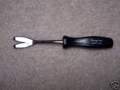

NowYaKnow
Gold - Posts: 1,217
Joined: December 18, 2002
Posted: November 05, 2004 at 9:10 PM / IP Logged
Panel Popper Tool...
trim plug removal -- posted image.

NowYaKnow showed what I need, I was just hoping there was another way.  I am all for buying new tools, but I need a quick fix, not mail order tools.

NowYaKnow
Gold - Posts: 1,217
Posted: November 06, 2004 at 7:38 AM / IP Logged
"I am all for buying new tools, but I need a quick fix, not mail order tools."
The tool above (not snap-on) can be bought at Advance Auto Parts stores for $5.
Mike

Thanks, I went and got one.
