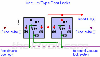

Door Triggers - 1991 Mercedes -- posted image.
 The vehicle should have vacuum locking and you will need to follow the above diagram to hook up locking ther should be a blue or green wire going to the vacuum pump witch is located under the rear seat you will have to cut this wire and place it in the circuit as illustrated. ( this wire will show a 12 + on lock or unlock but will show a 12v - in the opposite state. The alrm or keyless entry system you are fitting must have a selection to have a neg pulse of at least 2 seconds , if it doesn't you will have to place some kind of timer into the circuit.
