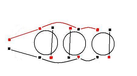

I just recieved my new subs. I went with 3 Infinity Kappa Perfect 12.1Ds. Since i have gotten them i have been thinking of different ways to build a box to have it be visually attractive. One idea that came to mind is loading one of the subs in with the magnet and motor out of the box and the cone pointed in the box. I have seen this before but i think i have read that you have to wire the sub differently. My question is how do you do this, and has anyone had experience with doing this and how will it effect the performance of the sub. Thanks

Yes, the inverted sub is wired with polarity opposite of the normal subs.  Just use whatever diagram you will be using, and change the inverted one + to -.  Post up a diagram of what you are going to do with the three subs to get to the ohm load you want.....or tell us.

ok i want around a 2 ohm load to put about 1200 watts to the 3 subs so around about 400 to each which is about the rms of the subs. ok so i just put the - to the + for one voice coil and the same for the other? just making sure im getting ya!

What are the subs, as far as # of voice coils (SVC or DVC) and the ohms of each?

they are dual 4 ohm voice coils

Wire like this diagram shows, series/parallel:
reversed loading of sub -- posted image.
Except, in your case one of the subs is inverted so its polarity has to be reversed in relation to the two other subs.  We'll use the middle sub in the next diagram as the inverted:
As you can see, the coils on each sub are wired as normal in series:  one coil pos to the other coil neg.  It is when the subs are connected in parallel that the inverted sub reverses polarity.  This will net you 2.67 ohm load on the amp, the lowest these three subs will wire to.  As the three subs fire in phase, the two normally-mounted subs will project the cone forward as the third reverse polarity inverted sub will project the cone backward.  All three will be in phase.
