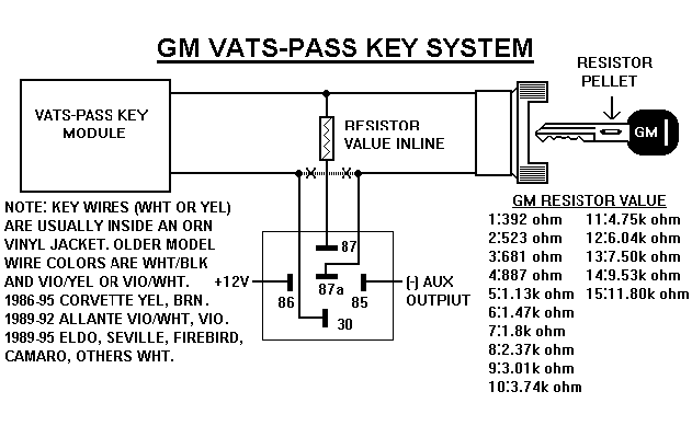

1996 Chevy Pickup gas, non keyless entry
have the door lock diagram
2002 Dodge Ram gas, non keyless entry, non anti-theft
i have the resistor and relay diagram for the door locks
2002 Ford Taurus, has keyless entry
will have security bypass module
1998 Oldsmobile Intrigue, resistor key, not sure about keyless entry. this one worries me with the double pulse lock and negative unlock, anyone know how to do this
any other problems you see i might run into. any help is greatly appreciated.

The only thing I can add is I dont believe you will run into a problem with the double pulse lock. I dont remember if it was an intrigue but i had the same issue with a car a while back but it only required a double pulse to lock the doors when the doors were open. That way you had to conciously lock your keys in the car. The second you closed the doors it only took a single pulse to lock the doors. Worse comes to worse most remote starters with keyless can be set to double pulse unlock so if you just reverse the lock and unlock wires and set it to double pulse it will pulse the lock wire twice. This works great on the remote starters that have one button that does lock and unlock.
