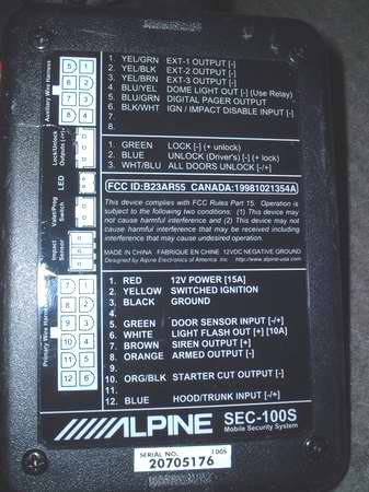

I installed the Alpine SEC-100S, since it's stick shifting, the shop refuse to install remote start for me, I understand about the safety issue.
Can anyone teach me how to install it by myself?
Teach me in the most stupid way please, some wiring daigram will be wonderful! Thank you!!
94 Integra Remote Start -- posted image.

I don't recommend putting a remote start on a manual!    But here are the diagrams.
ItemWire ColorPolarityWire Location
12Vwhite+ignition harness
STARTERBLACK/ white+ignition harness
IGNITIONBLACK / YELLOW+ignition harness
ACCESSORYyellow+ignition harness
SECOND ACCESSORYnone
TACHOMETERbluedistributor *1
POWER LOCKBLACK/ white-drivers kick panel *2
POWER UNLOCKBLACK/ red-drivers kick panel *2
PARKING LIGHTS +RED / black *3grn plug above fusebox
PARKING LIGHTS -blue/redfactory alarm (if equipped)
DOOR TRIGGERlt. GREEN/ red *4-drivers kick panel *2
HEADLIGHTSRED / wht (low) 12awg+steering column
WIPERSblue & blu/yel *5-steering column
LF WINDOW UP/DNRED / blu - RED / yelAin drivers door
RF WINDOW UP/DNblu/yel - blu/grnAin drivers door or dkp
LR WINDOW UP/DNgreen - grn/yelAin drivers door or dkp
RR WINDOW UP/DNyel/grn - yellowAin drivers door or dkp
TRUNK/HATCH PINgreen-*6
HOOD PINyellow/red-drivers kick panel
TRUNK/HATCH RELEASEnone
FACTORY ALARM ARMfactory remote only
FACTORY ALARM DISARMfactory remote only
HORN TRIGGERgray or blu/grn-steering column
BRAKE WIREGREEN / WHITE+brake switch
LOCK MOTORnonenonnone
UNLOCK MOTORnonenonnone
DISARM DEFEATnonenonnone
DISARM NO UNLOCKnonenonnone
DOME SUPERVISIONuse door trigger
SPEED SENSEorangeinstrument cluster
SUN ROOF OPEN/CLOSEgrn/red - grn/yelAsun roof switch
SUN ROOF LIMITnonenonnone
LF SPEAKERblu/grn - gry/blkradio
RF SPEAKERRED / grn - brn/blkradio
LR SPEAKERblu/yel - gry/whtradio
RR SPEAKERRED / yel - brn/whtradio
RADIO 12VWHITE/ blue+radio
RADIO GROUNDblack-radio
RADIO SWITCHyellow/red+radio
RADIO ILLUMINATERED / black+radio
POWER ANTENNAYELLOW /GREEN+radio
Notes:*1 Also found in a 16 pin white or gray plug to the left of the fusebox. *2 In the larger of two attached gray plugs in the lower kick near the firewall. If equipped with cruise control, the plugs are behind the module. To access, remove the lower bolt on the bracket holding the module and pull it up out of the way. The lock wires test only with the passenger lock and unlock switch. *3 Also a male blade terminal is available in fuse box. *4 Looks like 14 awg wire but mostly insulation. *5 Use both and diode isolate each. *6 12 pin blue plug on top center of fusebox.
