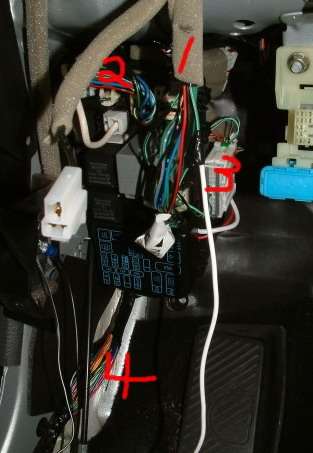

Can anybody tell me where to find door lock/unlock wires on my Mirage? I've finished almost everything but couldn't find lock/unlock wires. Door lock/unlock wires on 2002 Mirage -- posted image.  Any help will be appreciated.

2002 Mitsubishi Mirage, 2 Door, Thank you.

unlock should be blue/white lock should be light GREEN/ black at the bottom of the fuse box in a white plug.

I know the color of wires but there is no white plug at the bottom of the fuse box Door lock/unlock wires on 2002 Mirage -- posted image.. Thanks anyway.
