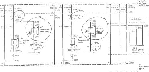

Ford Excursion -- posted image.
Would anyone agree that the positive and negative points that are penciled in are correct. I am not sure if I am reading the print correctly. Thanks!
