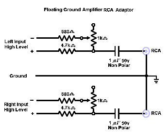

Here is the RCA adaptor I am talking about.
Two radios, One speaker -- posted image.

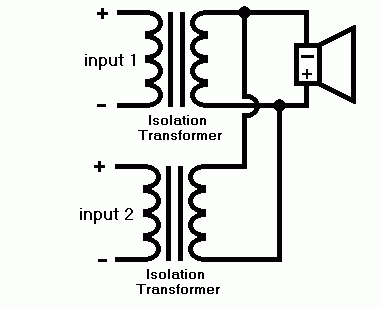

Here is your final circuit

hotwaterwizard
Silver - Posts: 1,350
Joined: December 11, 2003
Posted: November 28, 2004 at 2:09 AM / IP Logged
You could use the RCA Adaptor to make the Audio at low level, Then you could Use an Audio Mixer Circuit then send it to one Amplifier.
http://www.electronics-lab.com/projects/audio/034/Two radios, One speaker -- posted image.
John DeRosa (Hotwaterwizard)
Stockton California
When in doubt, try it out !

hotwaterwizard
Posted: November 28, 2004 at 2:23 AM / IP Logged
rknj01 wrote:
i would just use 2 relays
He wants to hear both at the same time thru one speaker.
 How would a relay do the job?
We don't want the output of one Radio to Feed into the output of the other because it could blow the Audio amplifier. So you have to Isolate the two from eachother then combine them into one.
The simple solution would be to use a small Dual Voice coil Speaker or a second speaker.
