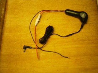

instead of creating my own voltage regulator to downstep the incoming 12V to 6V 1000mAh, i would just disassemble the cig adaptor and remove the side ground plate and positive wired tip piece from the enternal board, and solder a black for ground and a in-line fuse adaptor to hold the existing fuse that was once in the tip before stripping it.

Delphi SkyFi 2 power problem -- posted image.
