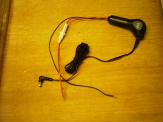

i'll post here my XM modified cig lighter adaptor, just so you can see what it would look like to modify one yourself. take in account, this is a 12VDC to 6VDC converter adaptor, like the Blaupunkt or Xact XTR1.
any other questions, just ask here or email. mrbrianrwebb@comcast.netWiring Sirius 2 car power source -- posted image.
