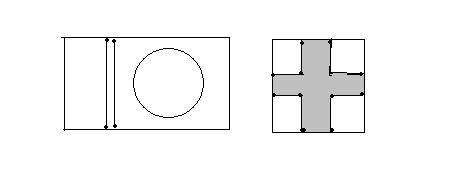

You don't need any kinds of special connectors (bisquit joints and such) when connecting the baffles (side walls, top, etc.).  Just the screws and gobs of glue.  You sound as if you're on the right track.  A box that size wouldn't necessarily need additional bracing if built well with 3/4 MDF, but it depends on which side the speaker hole will be cut.  You would look at the two longest 22" walls and see if the speaker interferes with the area around the center,  and if not you can build in a baffle from front to back, top to bottom there. The baffle would have to have large areas cut out of it to allow for air transfer.   Another method of bracing is to double-wall the face of the box where the hole will be cut to add extra strength to the structure.  Corner bracing shouldn't be necessary.  Any flex, if it occurred, would be at the centers of the longest baffles.
got my 9500, need a box -- posted image.
Interior volume is never messed up by adding bracing, because you have to measure everything you put in the box and account for the space it takes up by adding to the overall measurements.  As I said in my previous post, this also includes driver displacement and port area.
Measure in inches, then width X length X height will give you cubic inches.  Add up all the cubic inches, divide by 1728 to arrive at cubic feet.  Measure 10 times, calculate 20 times, cut once...the rule of thumb for building a vented enclosure.  ;)
