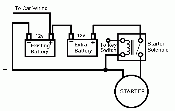

12/24v circuit Relays -- posted image.

              Thanks for the input, this is the circuit I use now, but it will not charge both batt. my thinking is, use two dpdt relays to switch between a series and parallel circuit  while maintaining 12v to the rest of the system.
              My concern is spiking and/or welding of the contacts. also thinking of how to use diodes to help. but were do you find them rated at 200amps or more?.
                                            Thanks again,  Frenchtown.
