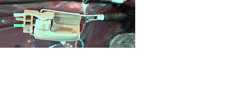

Sorry had to put this off for a while, but today I started again and took off my door panels. By looking at it I'm not too sure where to attach the rod to the latch. Can somebody show me from this picture where? http://www.members.shaw.ca/tkim4/lock.jpg

You will have to remove the door handle and make the hole where the cable is attached to the lock handle big enough for the lock cable and the door lock motor rod. Make the rod bent into a tight "U" so that it will not come out of the hole once installed.

I too have successfully accomplished the same task with no problems. It takes some time and patience but once you have one done and working, the others become fairly simple. Put the door back together to makes sure that the panel is not pushing on the actuator and binding up. Then remove the panel again so that you have something to look at as a reference point when starting the other doors.
In some cars you can go to the lock mechanism, in others it is easier to go to the lock switch.

If you haven't completed the job, here's some pics that might help.
Drill hole in plastic (locking mechanism)
Picture of mounted actuator
Power lock install on cable type? -- posted image.

Yeah I already mounted mine, thx for the pic. I mounted my actuators right under the handle, seems sort of like a stupid spot now but wutever already bent the rods and it looks like it'll work. Now I'm just workin on my alarm install, been so busy with other things, Hopefully by this weekend everything will be done. Thanks all :)
