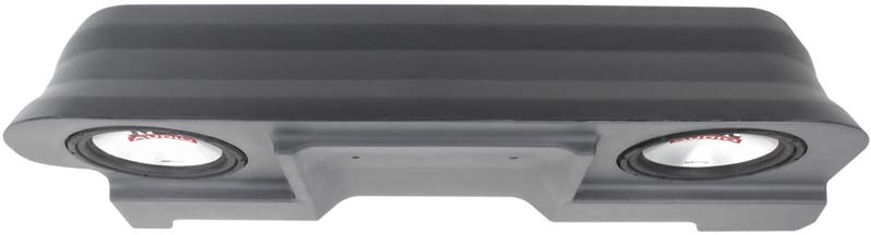

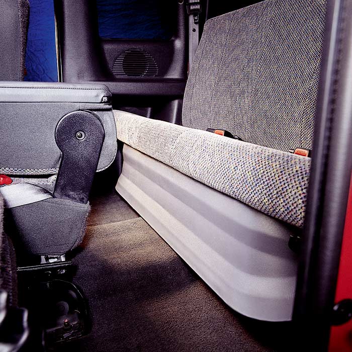

ALSO FITS QUAD CAB Proper speaker choice -- posted image.
  • Location: Under rear seat
  • No loss of leg room
  • Bolts to vehicle with supplied hardware (cut out in rear of ThunderForm allows factory jack arm to remain in current location). Jack is unaffected.
  • Absolutely seamless-no seams to fail
  • Molded in factory colors
  • Subwoofers: Two 10"
  • Install Sheet in PDF format. (751kb)
Dimensions: 8.687" x 48" x 17.5"
Weight: 38 lbs.*
Power Handling: 450 Watts RMS*
Sensitivity: 87.4dB*
Enclosure Volume: 1.7 cubic feet
Impedance: 4 Ohm*
Now, I couldent find my model amp because it is last years model, But here is this years model. I beleave that the output is the same.
