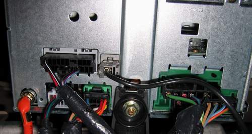

Thanks to NowYaKnow I was able to remove my head unit easily.  Now I need to know which connector feeds the CD changer.  The model number on the unit is 2L14-18K931-CK.  Here's a pic of the back of the HU.
Removal of Head Unit in '04 Expedition -- posted image.
I thinks it's the plug just left of the nut in the center, that's the plug that shares the most wire colors with the connector at the CD changer.  Any confirmation is helpful and appreciated.
Thanks again.
