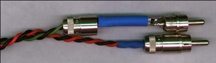

I'd say it's time to start rollin' your own............too much money going to waste.
Good Quality RCA's -- posted image.
(pic stolen from http://www.bcae1.com/installationprimer.htm)
