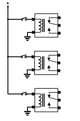

Posted: January 29, 2005 at 8:35 PM / IP Logged
Is this the Circuit you have now?Help with Design? -- posted image.
