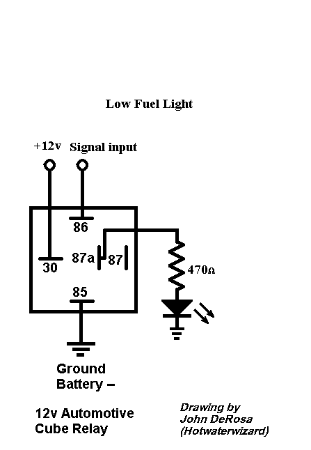

Hi, I'm doing some custom stuff to my bike. The stock dash is being removed which has the low level fuel light on it. The low level light is off @12 volts (from signal wire), but when the fuelsending unit see its on reserve it drops to 0v on the signal wire and turns the led on in the dash. Is there a way to wire this up to a relay to turn on a led when the voltage goes to 0v.

turn on led @ 0V with 12v being off -- posted image.

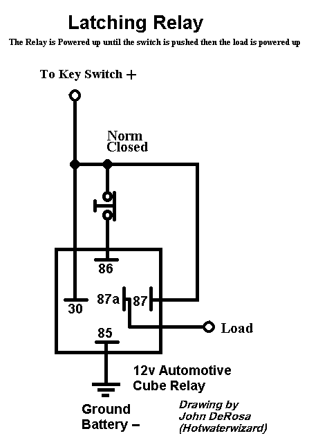

OOPS Wrong Circuit Sorry
Here is the  NEW ONE
You know the LED needs a Resistor on it.
