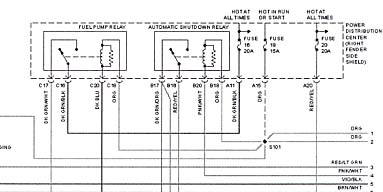

I have a situation, I have a 97 Jeep Grand Cherokee 4 cylinder.  The computer went bad on it about a month ago I took it to a mechanic and he installed a new one, it drove fine for about a week and then the vehicle died on me again the same excact way, so I had a different mechanic take a look at it and he found that the ASD relay was out of the harness box were it was supposed to be and that the wires were not protected from touching one another, and that fried the computer again.  He also did not put the relay back on to the wires he just handed it to me.
I have a new computer now and I dont know what wires go to what pin on the relay.  I drew the diagram with photoshop that is on the side of the relay, its not the best  maybe somebody here can help figure out what wires go to what pin. I have a pink wire, an orange wire, a red wire and two green wires that turn into one.  If there is anymore information that is needed please let me know.

Hope this helps
ASD Relay Jeep Gr. Ch. need color scheme -- posted image.
