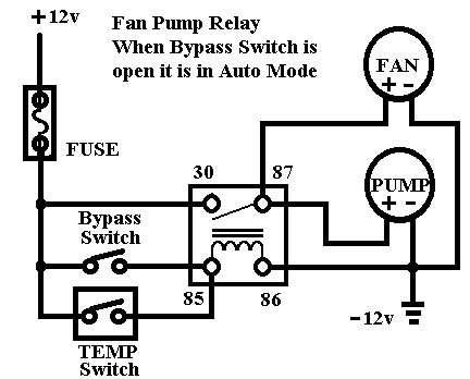

Posted: February 11, 2005 at 8:34 PM / IP Logged
how do i go about wireing a electric fan and waterpump i would like to have them come on at the same time manually when im in beetween rounds of racing  but also want to put a thermo switrch so they come on normally at whaterver degree the thermo switch is set at  so pretty much i want to put a manual bypass in  anyway it is going in to a 97 honda civic

Posted: February 12, 2005 at 1:58 AM / IP Logged
relay for elec. fan and waterpump -- posted image.

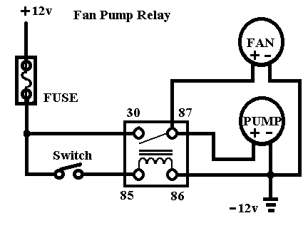

Posted: February 26, 2005 at 9:56 AM / IP Logged
ok lest say i wire the fan direct to a 12 volt source  with a manual switch and 30amp relay without thermo  switch

Posted: February 26, 2005 at 8:13 PM / IP Logged
