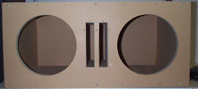

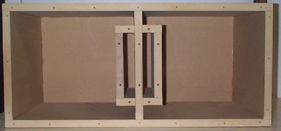

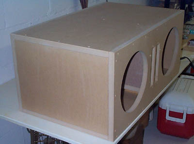

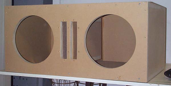

I was able to build my own subwoofer box.  I came on this site after hearing about it from others, and I must say you guys helped me more than i thought you would.
I initially thought that asking you guys for sizes and specs. I would just get some rough ideas or no answers at all.
What I got was an education in:
 how to figure the volume of my cabinet
 to how to tune a port to 30 hz
 as well as to using some math skills I have never used before
you guys didn't just give me the answers but helped me figure them out myself.Thanks to U guys,I made it(pics) -- posted image.
to all the noobs who are expecting easy or quick answers to their box sizes and port sizes, it's probably not gonna happen.
if you are lucky enough, what you will get is a good education.
I did.
I know my box is nothing special but its my first, and i am happy with it so far.
16" high x 34 1/2" wide x 17 1/4" deep
port opening- 1 1/2wide x 8 3/8high x 13 5/16deep
made for 2 12" jbl subs
each compartment is braced with a 3 1/2 " wide(cross-shaped) piece of mdf
liquid nails and 2" screws(pre-drilled)
1" mdf construction
HEAVY AS F#%K-------- 101 LBS  UNLOADED

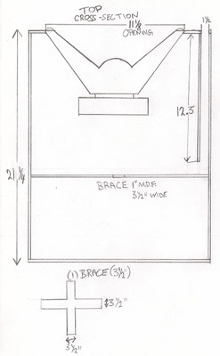

Nice job.  One question (you knew ther'd be one, right?)  How much space did you leave between the entrance to your ports and the back wall of the enclosure?

kingpin111
Member - Posts: 38
Joined: February 10, 2005
Posted: February 22, 2005 at 11:05 PM / IP Logged
i hope this question answers what you are asking.
kingpin

kingpin111
Member - Posts: 38
Posted: February 22, 2005 at 11:08 PM / IP Logged
boy, i wish i could edit my posts.
from the angle of the pictures and the shadow it doesn't look like much but if i am understanding what you are asking it is roughly 9"
kingpin
